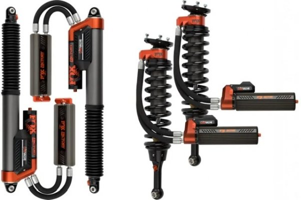

Coil-overs are the big guns when it comes to improving your suspension. With many options coming from ADS, Fox, King, Icon, it can be difficult to understand how the ride will differ. The fox race series is currently the only option that will allow you to change your coil-over while maintaining your live valve electronics out of the box and is engineered to feel the most like a stock raptor, while offering drastically more off-road performance.
There are three main differences between oem and Fox Race Series (FRS) live valve. The largest performance benefit comes from the drastically larger oil capacity with the external reservoir which translates to drastically higher shock fade resistance. The remote resi on the fox is the only recirculating system for the gen 2 (and fits gen 3) raptors, they are dubbed the cactus coolers.
Second is the height adjustability . Get the stance you want by adjusting the preload for front end height increase of 1”-2.75” and being able to match the rear ride height no matter what type of setup you have back there. The gen 3 will lose an estimated .5” rear travel by utilizing gen 2 FRS shocks.
Third reason to upgrade to FRS is to take advantage of the 3 settings on the bottom of the shocks to fine tune the feel of your ride quality even further. Choose between on-road comfort, on-road performance, and pure off-road performance. The QS3 adjuster controls BOTH rebound AND compression unlike the manual adjusters on the icon/king/ads which has one dial for each. The FRS Live Valve lets you choose what you want, and the computer does the rest.
