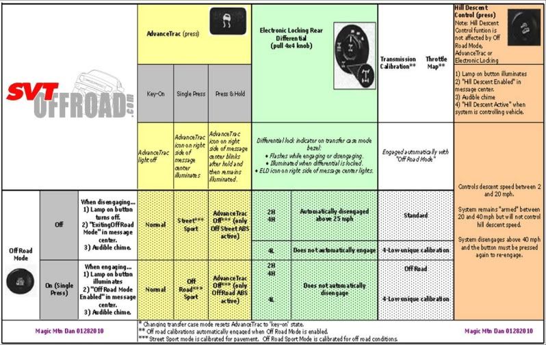

Q1: What settings for sand? I used 4WD, Diff Lock, OFM, Trac Control Off. When I stopped for breaks or slowed too slow, the truck wouldn't spin out at all making it very slow acceleration, I don't wanna bury it but it's nice to spin out and drift but something wasn't letting it. Even in 2wd?
Whenever you stop the truck, depending on what you do (like shut it off), you'll need to go through your settings again.
You may know this and/or it may be different since you have a newer Raptor but at least on the 2010's if you kicked it into 4H (or 4L) it reset the AdvanceTrac so you needed to engage it again.
Thanks, hopefully traction control won't kick in when it's off! Not too sure if my power steering will get hot, not sure how it works but it's electronic. No power steering pump or fluid.
Yeah I make sure the settings are all still enabled. I have an off road screen on mine that shows certain settings that's enabled, I just leave it on that screen to make sure it's all good to go! :)
it will kick in eventually. you can not fully disable traction control.
