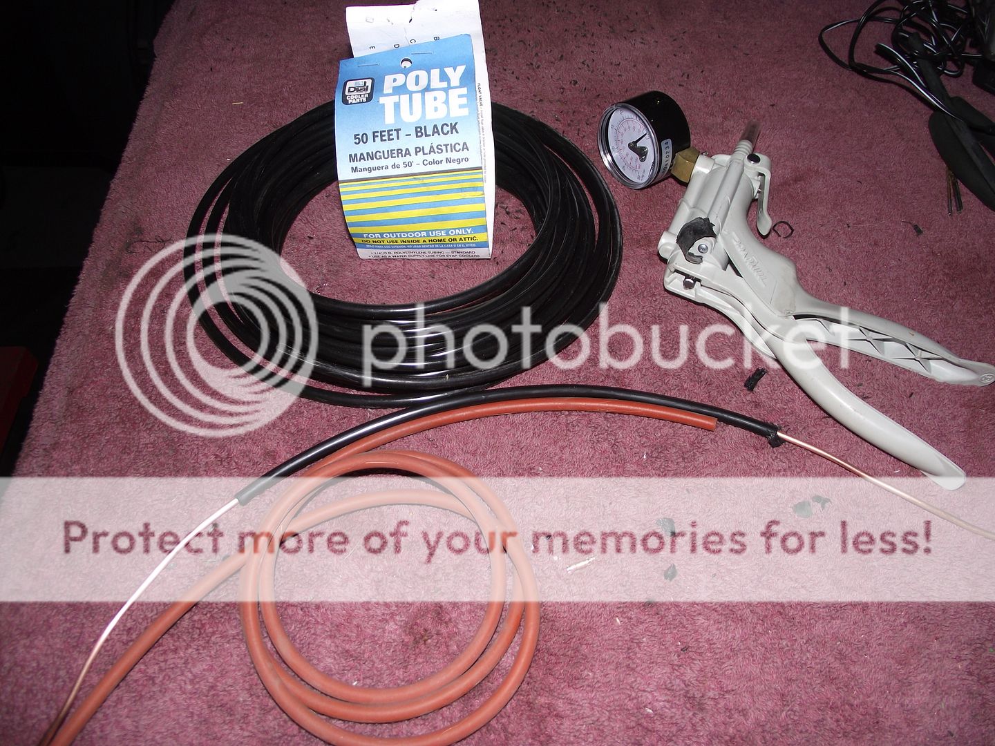

I used ¼ inch copper tubing approx. 7 feet, 3/16 inch silicon vacuum hose and some poly tubing to build a new vacuum line. Cost approx. $30 at Napa. I used the copper tubing as the vacuum line and the poly tubing as a protective sleeve over the copper for rocks or anything else that may cause damage to the line.
The parts I used. You can see how the poly tubing fits over the copper tubing. This is only an example. My finished piece was approx 7 feet long from Driver to Passenger sides. There was also the silicon tubing that I used in some small areas. Silicon lasts and with stands abuse much better than regular black vacuum hose.
It also makes it much easier to work with as the poly tubing is slippery and allows the copper to be worked with without crimping or bending and causing breaks or smashed copper tubing. I used the same attachment points as the stock tubing. I removed the old plastic tubing and saved it for the venting line that I will talk about in a little bit. I decide to treat each vacuum line and vent line separately. The vacuum line and the vent line are why there is a dual chamber rubber tubing that I mention earlier. The reason will be obvious in a little bit.

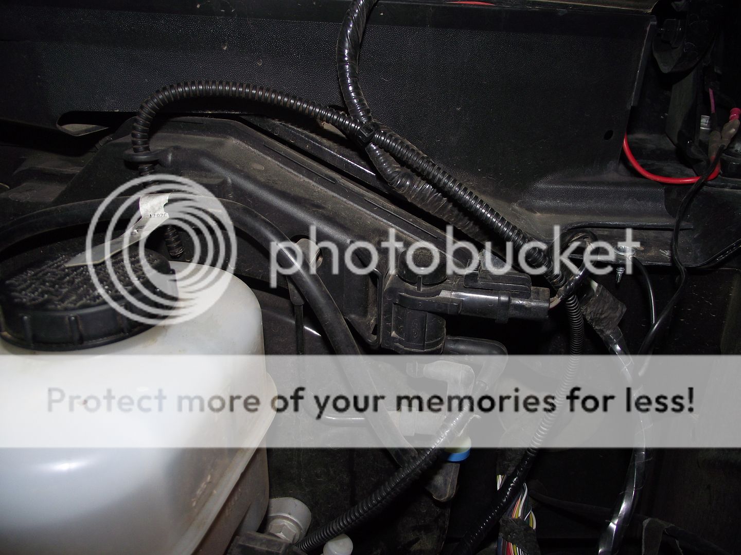

I took the down tube from the brake booster reservoir that creates the vacuum and kept it all as one in stock form.
You can see the stock tube in this picture. It’s the one with the rubber 90*
Fitting just to the right of the brake reservoir in the plastic sleeve. (Sorry I don’t know how to draw an arrow in a picture image)

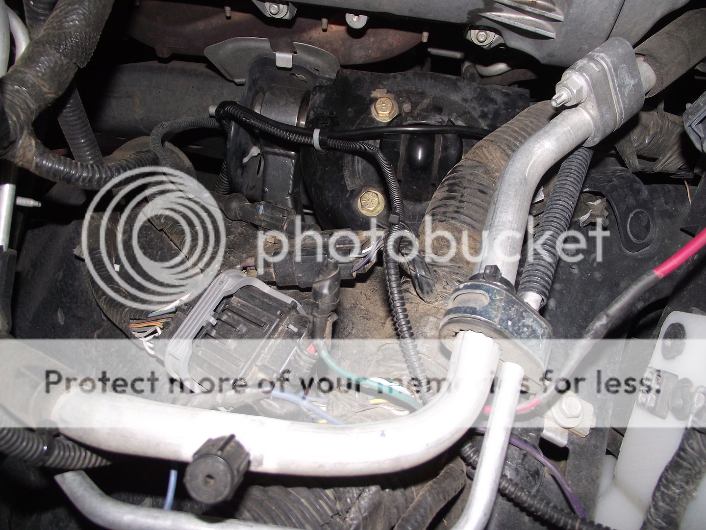

This is not one of the problem areas for cracking or breaking and the line works well as is. This line runs down over the driver side upper shock tower into a T fitting that intersects with the vacuum line that runs between the two front hubs.
You can see the T fitting coming down and just behind the large rubber hose. It is going to the dual chamber hose that I wrapped in the larger plastic sleeve. Here you can also see where the copper hose in the poly sleeve is going over the Shock tower and down the frame where the white tie wrap is holding the T to the large rubber tube.
I ran a piece of silicon tubing from the T fitting and attached it to the dual chamber rubber tubing that comes up from the actuator on the back of the hub. Then I built the new copper with poly sleeve that runs from the T and goes over the upper shock mount twisting and turning down and across the frame and front cross member in front of the axles. I then continued it to the passenger side frame up and across the upper shock tower on the passenger side and attached it to the dual chamber vacuum tube that runs to the actuator on the back of the hub.
You can see in this picture the new line running over the shock tower to the dual chamber tube just to the left of the upper control arm running down to the hub. (on the stock oem lines, this is the common area that the plastic line will crack or break.) see the exhaust manifold just a few inches from the vacuum line? Usually there is approx an inch of plastic line that is exposed right there on all 4x4 Ford trucks.
