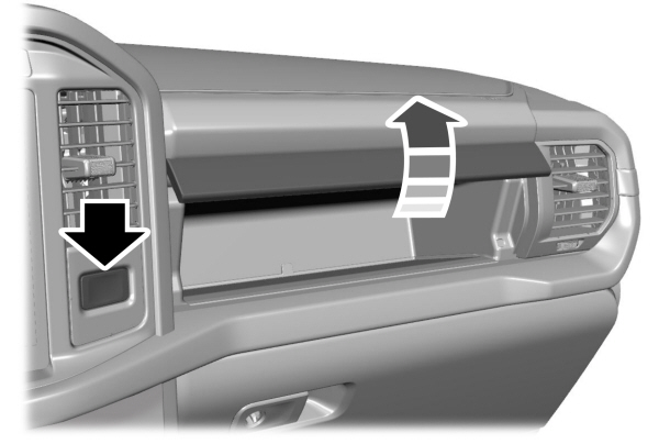

<blockquote data-quote="dragonass23" data-source="post: 1889018" data-attributes="member: 65045"><p>I notice when changing my cabin filter that someone before me had broke the “soft” opening mechanism and the gear was laying at the bottom of the compartment behind the glove box. I was able to pop the rail on the right side off and reinstall the gear in the rail. Works fine now. Perhaps this part or something else got into your opening mechanism.</p></blockquote><p></p>
