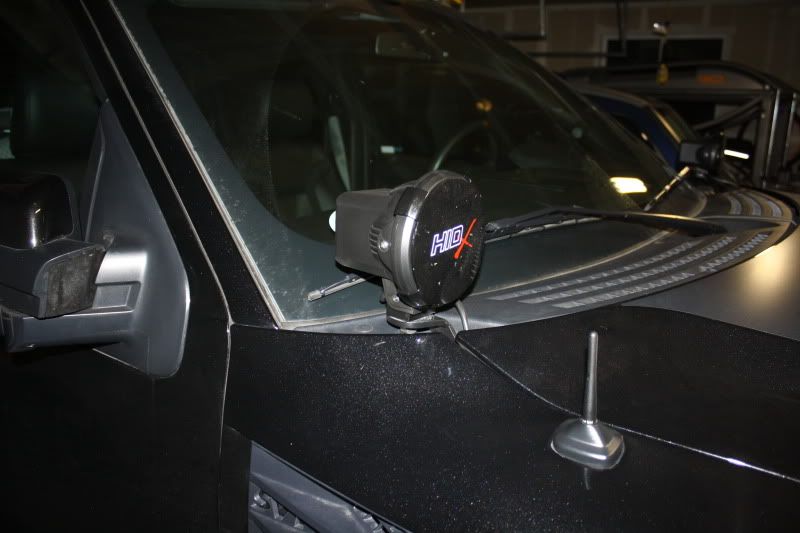

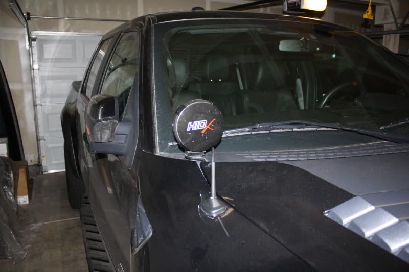

Here are some pics of said black covers... with some nice bug splats on 'em from a recent trip. Because of the Tuxedo Black, they're actually barely noticeable from a distance... I doubt that same look would carry for other colors.
The 4" HIDX lights are identical to the Kragen/Oreilly, and Hella Optilux lights. Made in China. But they appear to be sturdy enough, especially for the money. You get a wiring kit capable of wiring a set of 2 lights together, with each light. Most of which was unused because of the Raptor's upfitter wiring. My only modification to the wiring that came with the lights, was to splice on extra wire for the ground, so it would reach the grounding point on the passenger side of the engine bay.

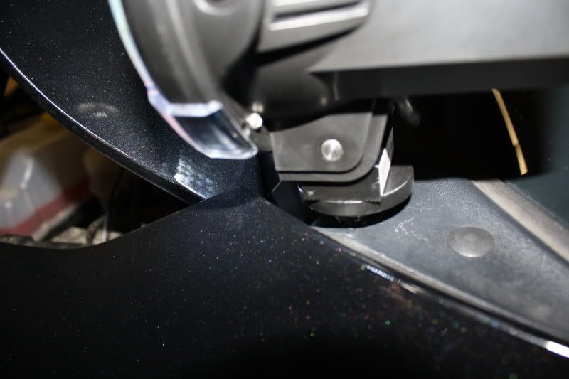

My only gripe with these lights, are the way they're adjusted for aiming. Unlike other companies that utilize dual tightening screws on either side, allowing for infinite angles, which are separate from the mounting bolts. These use the single bolt and a set of teeth, for both mounting and angle adjustment. Those teeth are what presented the problem for me. For whatever reason, the passenger side Outlaw mount was just a tad higher in the back than the drivers side. This meant that the limited zones of adjustment by the teeth, put the light either too high, or too low.
After pissing off the neighbors down the street by the constant up and down motion of the light into their windows, we decided to compensate by shimming the front of the lights mounting block, with a piece of zip-tie... worked out perfectly actually.
Here are the clear covers, and a look at the clearances. Plenty of room for larger lights, but I like the low visual impairment of these 4 inchers.
