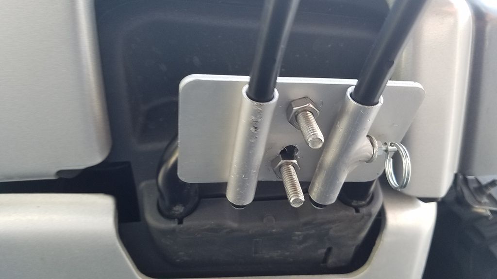

I bought the sto-n-sho license plate relocation kit from cj pony. I did not like how it still blocked the intercooler partially. It is way better then the stock location of the plate, but IMO still cuts a significant amount of air flow to intercooler. I heated the end with a torch and bent it straight up and down, then i got a u-bolt from a hardware store and mounted to my tow hook. I does take away the use of the tow hook, but worse case there is the other one up front. If you go offroad you can pull the pin on the plate holder and remove it.

Is there anything to stop the mount from rotating downwards on the tow hook?

If the posts they gave you on the plate mount were longer that would work. The way it is mailed and the angle and length they give you leaves you with little choice

it doesn't move up and down because the flat side is bolted tightly to the hook, it did move side to side until drilled one of the holes in the plate out larger so the u-bolt was completely snug. See photo below
