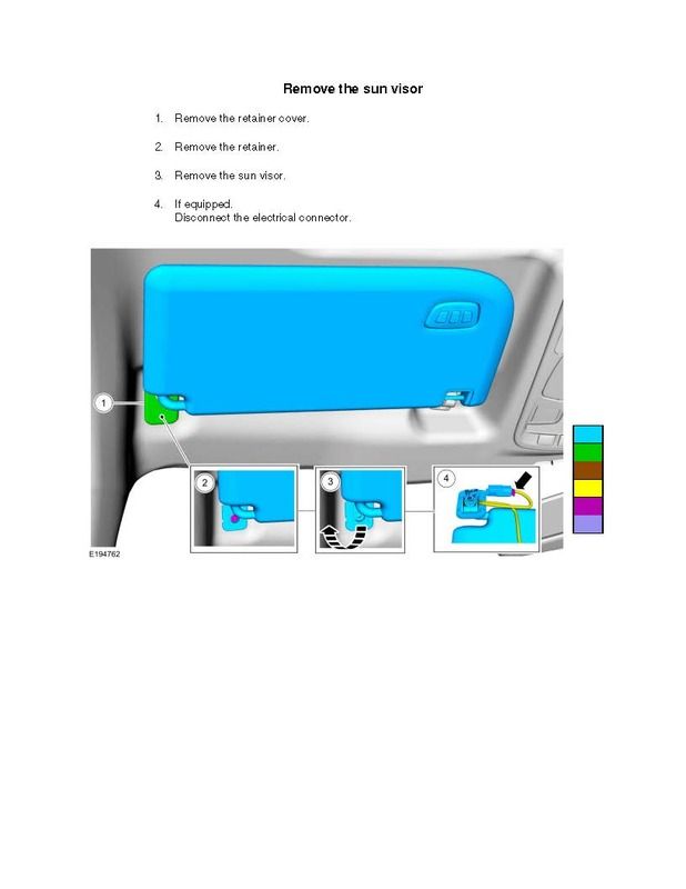

I did it, Bought the Ford Sun Visor from Ford and installed it in less than 5 minutes.
1. Part to order for a Black interior 2018 F150 Raptor ($160 at employee pricing)
2. Take off Black Sun Visor using these instructions, pop of black plastic cover , use 8mm to take off screw, take off power, and reverse to install new visor.
Install%20Sun%20Visor.jpg.
3. Install Visor
4. Sorry Army guys, this was that easy.
